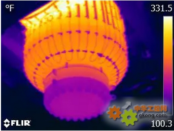

[face=楷体_GB2312]关键容器监控[/face]
