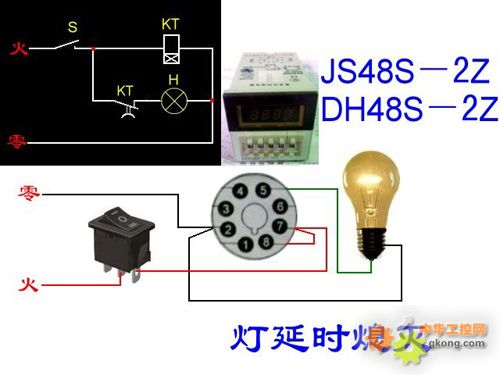

以下提供一些电工最常见照明灯接线电路图,只供参考:
1、双联开关的两种双控电路
http://www.dq-fx.com/UserFiles/20120531/201205311016542570.jpg
2、通电延时亮灯
http://www.dq-fx.com/UserFiles/20120531/201205311018348510.jpg
3、桥式全波整流滤波电路
http://www.dq-fx.com/UserFiles/20120531/201205311019462650.jpg
4、两种控制方式
http://www.dq-fx.com/UserFiles/20120531/201205311020565960.jpg
5、双灯双开关
http://www.dq-fx.com/UserFiles/20120531/201205311022259440.jpg
6、延时断电电路
http://www.dq-fx.com/UserFiles/20120531/201205311023141270.jpg
7、延时通断不断循环且达到设置循环数断电
http://www.dq-fx.com/UserFiles/20120531/201205311024129210.jpg
8、延时熄灭电路
http://www.dq-fx.com/UserFiles/20120531/201205311027127560.jpg
9、传统镇流器和电子镇流器
http://www.dq-fx.com/UserFiles/20120531/201205311027482860.jpg
10、通电延时断电
http://www.dq-fx.com/UserFiles/20120531/201205311028286240.jpg
11、循环流水灯www.dq-fx.com
http://www.dq-fx.com/UserFiles/20120531/201205311029069850.jpg
12、两灯循环点亮
http://www.dq-fx.com/UserFiles/20120531/201205311029427410.jpg
13、延时通断不断循环且达到设置循环数断电
http://www.dq-fx.com/UserFiles/20120531/201205311030303810.jpg
14、延时通、断循环运行
http://www.dq-fx.com/UserFiles/20120531/201205311031168490.jpg
15、两灯循环亮和熄
http://www.dq-fx.com/UserFiles/20120531/201205311031468780.jpg
16、桥式全波整流滤波电路
http://www.dq-fx.com/UserFiles/20120531/201205311032234020.jpg
17、时间继电器断电延时控制
http://www.dq-fx.com/UserFiles/20120531/201205311032536150.jpg
18、时间继电器断电延时控制
http://www.dq-fx.com/UserFiles/20120531/201205311034239350.jpg
19、通电延时断电
http://www.dq-fx.com/UserFiles/20120531/201205311035214270.jpg
20、通电延时亮灯
http://www.dq-fx.com/UserFiles/20120531/201205311035464330.jpg
只供参考:www.dq-fx.com

从原理图看来立即就灭...................

大部分是初中物理的 玩意,只是初中物理还没有讲到 接触器 与 延时继电器

单极开关是不允许L,N同时进入的。

形象直观,适合初学者.
